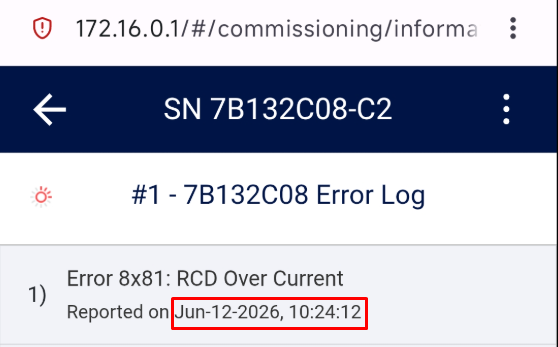

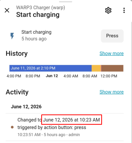

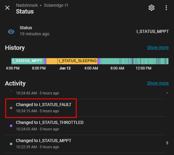

Solar inverter (SolarEdge 16K) shows it faults due to RCD Over Current - I assumed due to DC injection for self-test because dedicated RCD 30mA AC for EVSE never tripped. See screenshots below of Home Assistant and SolarEdge status..
The fault occurs each time car is plugged in and charge starts. If charging is restarted without unplugging, the fault doesn't occur.
