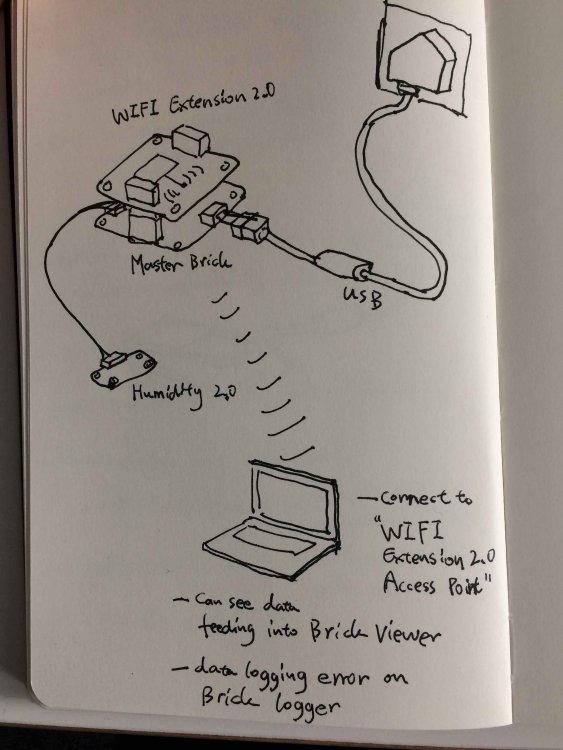

Thank you for the advice and I am now powering the stack with a power plug. Please see attached image on the set-up.
However the error remains as the same as my previous set-up.

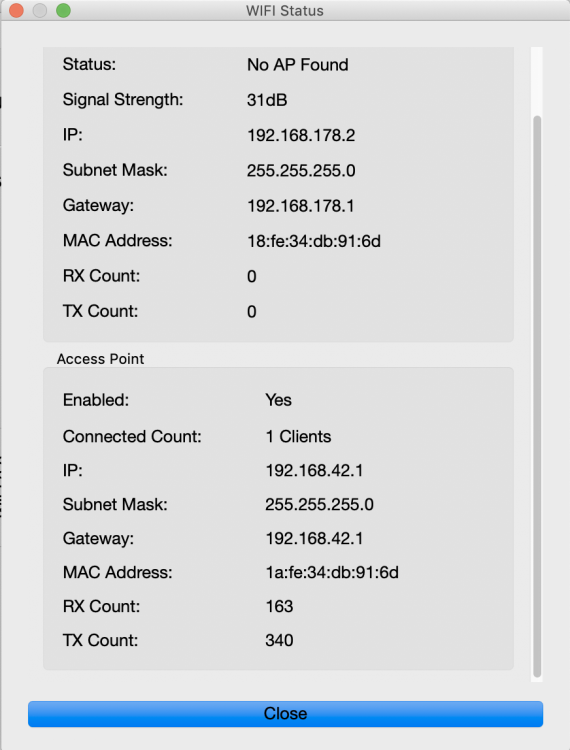

Thank you very much for the update! I've checked my wifi status, and there seems to be an issue with my Client mode connection (Please see attached image). The signal strength is very different from yours.
I then set the connection mode to Access Point only, and the data logging error disappears.
We might need to build a network of sensors in a large number of rooms and send data using a WIFI mesh or an alternative option to a database server, would the issue with the Client mode be a problem in this case?
Maybe it is problematic if the client mode is configured to an AP that does not exist and the connection always fails?
But in mesh mode this is not the case, so i wouldn't expect any problems there.
