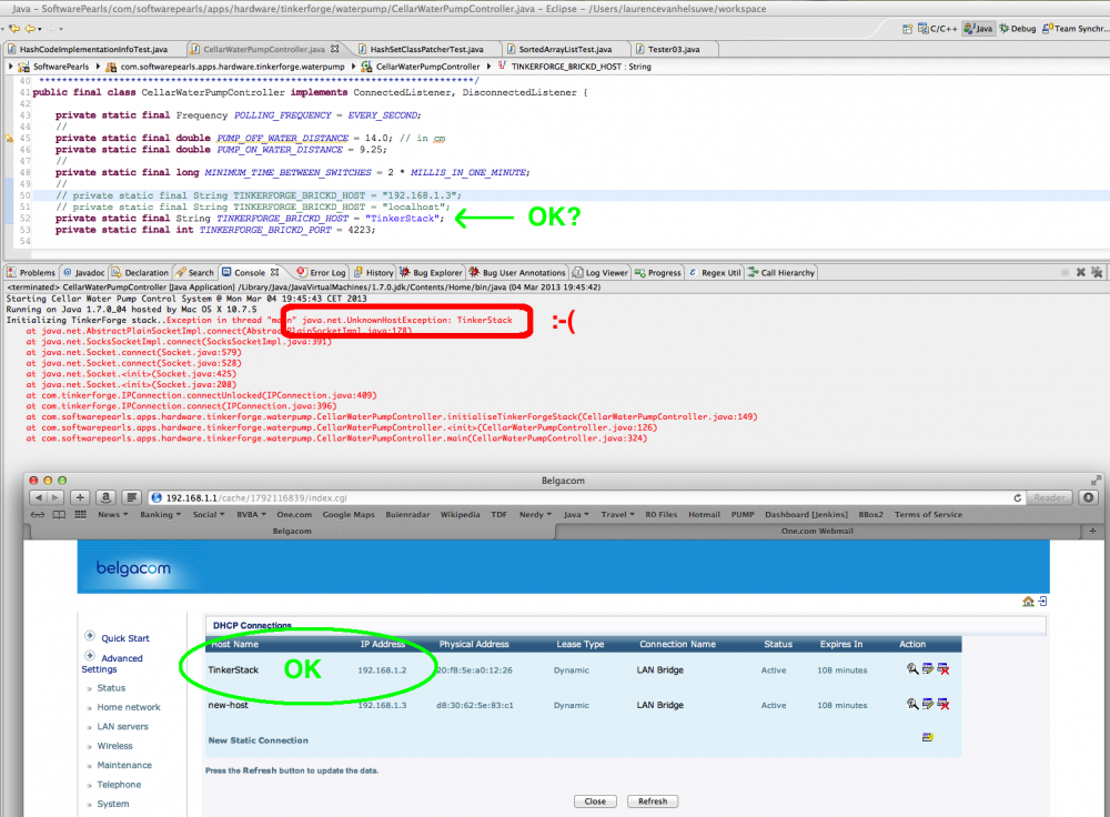

Borg: OK, Master upgraded to 2.0.5, setWifiHostname() via Brickv. AP clearly honoring this (see screenshot), but if I try to substitute this non-numeric host address in my program, then I get a java.net.UnknownHostException.
Also, if I try to ping the name of my stack from the OS command line, then my Mac also does not recognize the name. Am I missing something ?

Does your AccessPoint also has a DNS server included?
And do the network clients use your AP as DNS server?
If not, setting only the hostname in the WIFI extension will not help.
My FritzBox is also a DNS server. In this case the WIFI ext. registers at the FritzBox AP with the given hostname, the Fritzbox also adds the name + the IP to its DNS mapping.
All network client in my network use by FritzBox as DNS server, so I can connect to any other WIFI device using the hostname with was defined during WIFI connect - this was really easy, but a DNS server in the AP is a must have I think.
