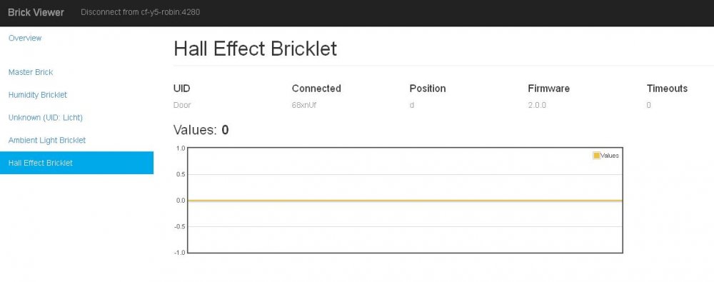

I just added support for multiple graphs in one graph view and implemented it for the Temperature IR Bricklet. I will take a look at the setMode function tomorrow.
Edit: I don't like the distance between the two temperature <h3>'s in the new temp ir plugin and the text below the graph is a bit to close. But the good thing is that we can easily beautify the HTML later on, it will then automatically work for all graphs in the plugins ;).
