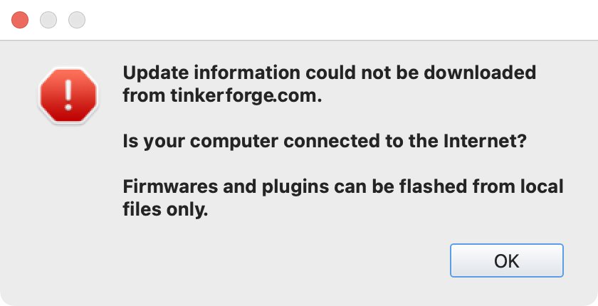

Brickv macOS : "Update information could not be downloaded…"

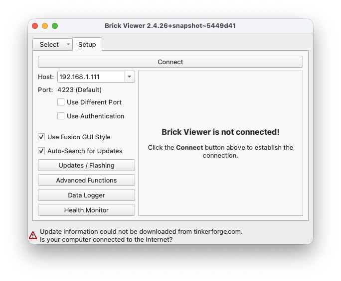

Mir ist die Meldung unten im Brickv auf dem macMini aufgefallen. Weiß nicht, seit wann das da steht. Beim MacBook taucht sie nicht aus. Ich bin mir nicht bewusst dass ich etwas umkonfiguriert habe. Eine Idee? Ich finde nichts an Berechtigungen für Brickv ... Werde mal neu installieren
macMini M1, macOS 26.2, neuester Brickv 2.4.26, gerade noch mal installiert.
Cheers, Uwe

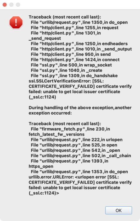

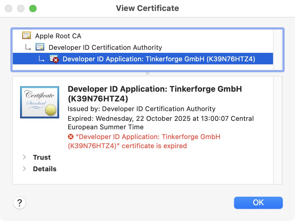

Same here with Brickv 2.4.24. Weird, because version files seem to be fine here and here. Maybe a code signing thing with Apple?
Update: it seems the developer certificate expired.

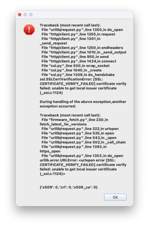

Completely removed Brickv 2.4.24 using Tinkertool Rebooted Installed Brickv 2.4.26 → Still the same problem.

There are two different issues. We moved our servers to a new infrastructure and by doing that changed the root ca. Because of that brickv doesn't like to download from tinkerforge.com anymore. Additionally we need to renew the developer cert for the next brickv release, but that is a different issue.
Hmm, I'm pretty sure I run the same version of Brickv on the same version of macOS in my office. There everything runs as expected.
